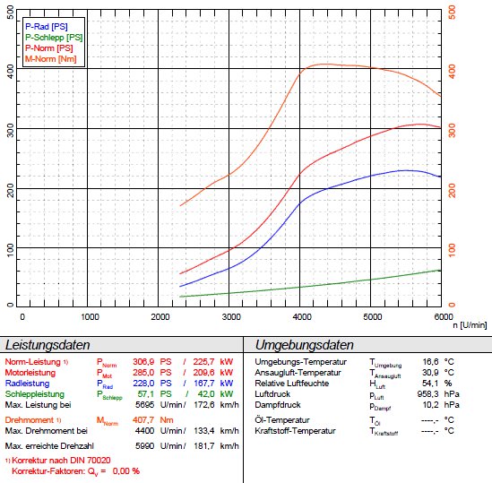

    I hope to rev to at least 7,500 rpm. Power and Torque?
    Car to go on the dyno very soon!

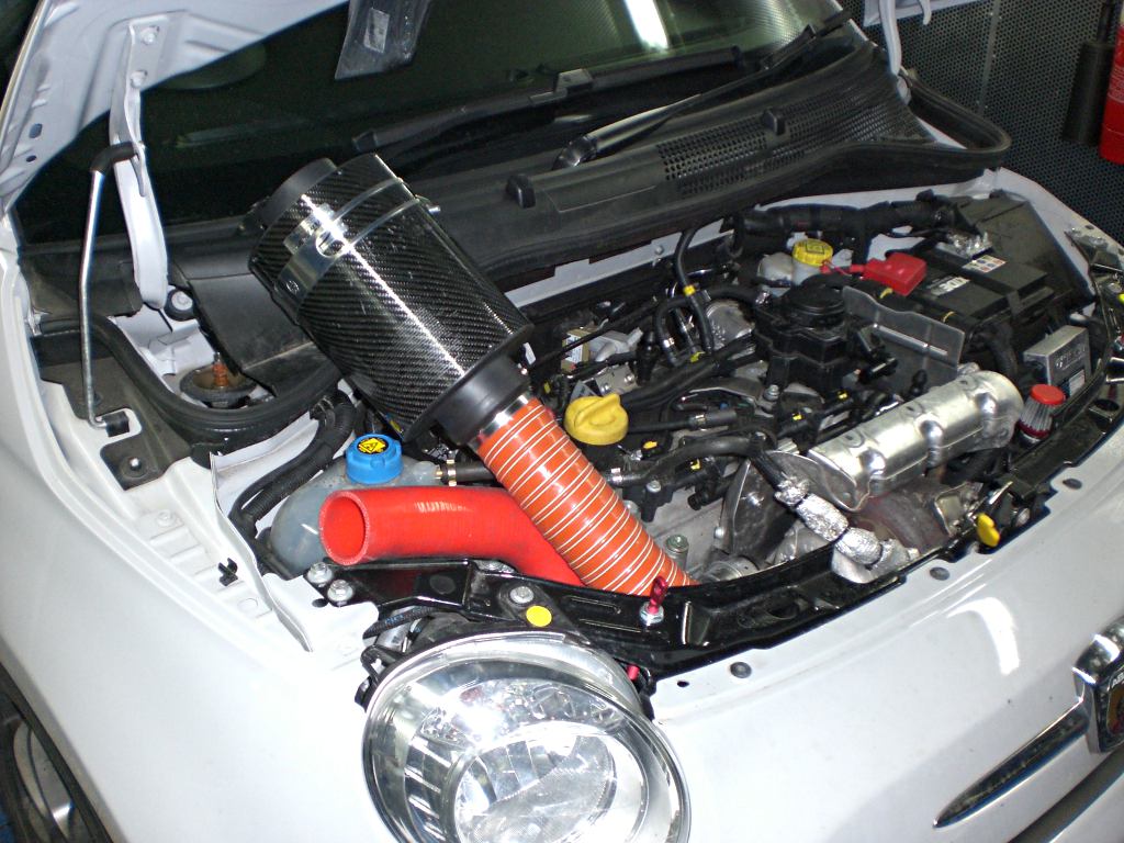

    Hello all,
    I come to Stetten this Thursday morning to collect car from Helmut! See pictures of BMC airbox and 307PS configuration!
    I want a cold air feed from NACA duct. So I will either swap the NACA duct to the other side of the bonnet and get the cold air feed there, or run a tube (probably something solid metal/carbon) across the cylinder head and back into the filter then out to the existing NACA duct.
    The BMC filter is huge to support 300+ PS. Normally in Ferrari/Lamborghini there are two smaller filters.
    Cheers,
    LL
