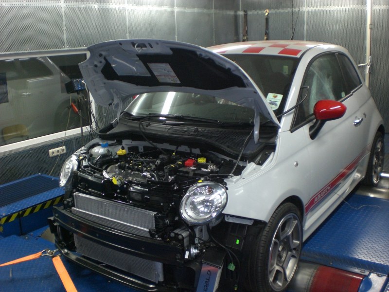

  • When I was i Stetten too pick up my car I saw this Abarth 500 under contructions by Helmut and Gtech.
    Hope you have lot off fun :D

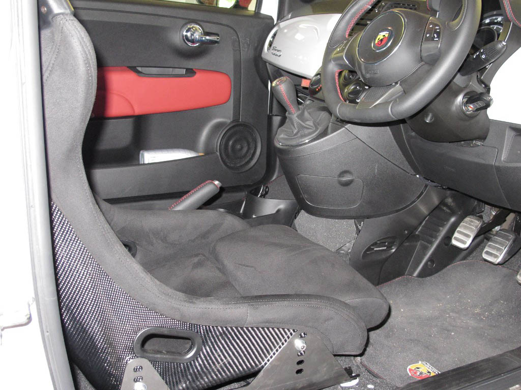

    Next, I am fitting KW variant 3 coilover then OMP bucket seats and half rollover cage.

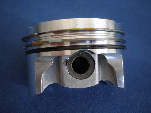

  • very nice.
    i hope i get your pistons.
    at the moment the company can´t deliever the pistons.

  • Excellent, so many fast Abarth on here! Not many fast Abarth in UK at the moment.
    When I was at G-Tech there is an Italian 500 going for GP/R kit too.
    I would like a six speed gearbox next for the car. It would really benefit from shorter ratios. In the UK, top speed we can do is < 150 kph, so acceleration is more important than top speed.
    I would love to be able to drive frequently in Germany, you are very lucky to be able to drive at high speed!!
    Also, your roads are so smooth, UK roads are terrible, standard Abarth suspension is far too stiff for UK roads but perfect in Germany & France.

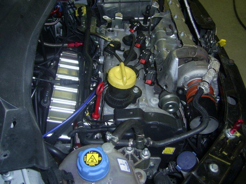

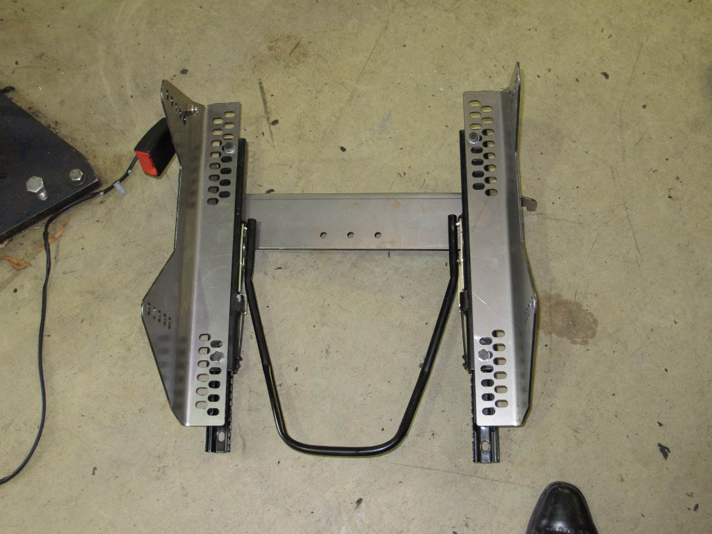

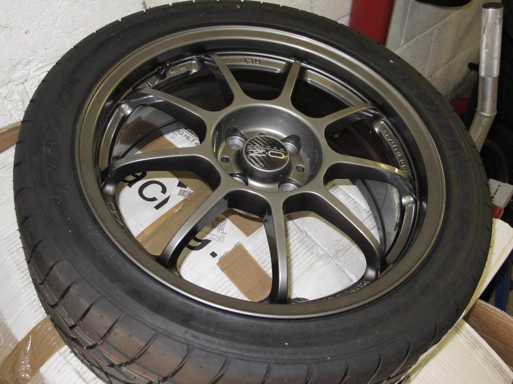

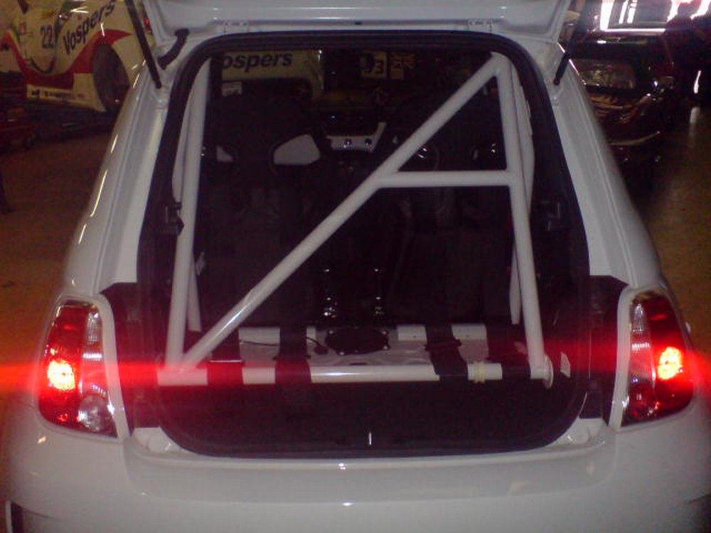

      (156,81 kB, 1.785 Mal heruntergeladen, zuletzt: )
      (200,44 kB, 1.732 Mal heruntergeladen, zuletzt: )
      (47,63 kB, 1.682 Mal heruntergeladen, zuletzt: )
      (164,41 kB, 1.693 Mal heruntergeladen, zuletzt: )

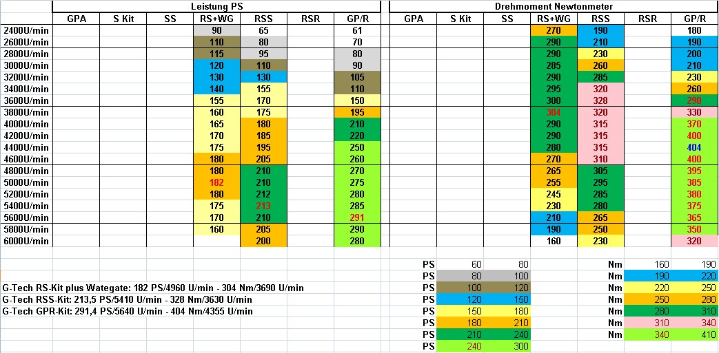

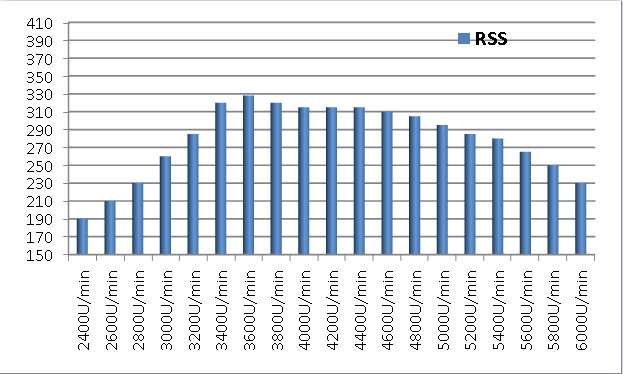

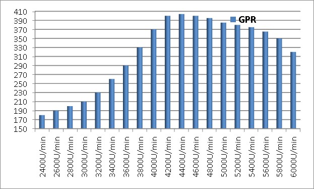

  • Nm Vergleich zwischen RS, RSS & GPR
    RS Nm 304 bei 3690 U/min (182 PS)
    RSS Nm 328 bei 3630 U/min (213,5 PS)
    GPR Nm 404 bei 4355 U/min (291 PS)
    2 Mal editiert, zuletzt von szhgc12 ()
  • Abarthmen
    ich danke dir. Ich habe mich bemüht - naja mich hat es ja selbst interessiert wie es so mit dem Drehmomentverkauf aussieht. So kann man super vergleichen! Fakten sind immer besser als Prognosen. Und so werden die Stärken und Schwächen von jedem Kit visuell aufgezeigt :D
    lG
